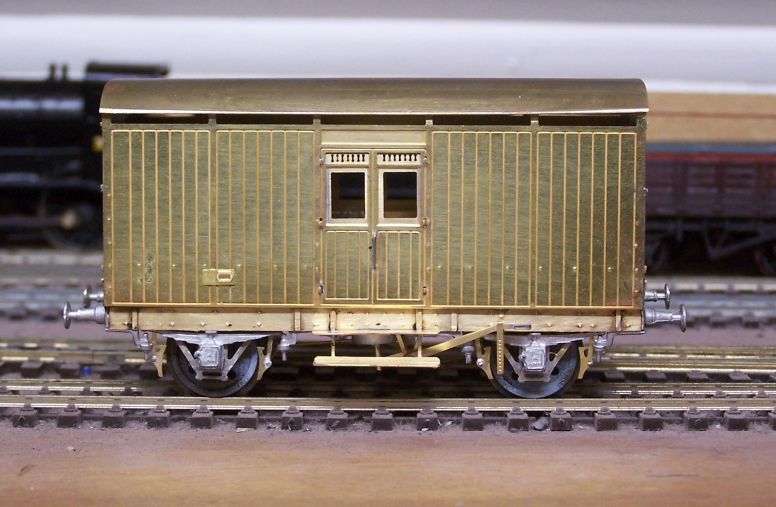

This is DS 289, which Andrew tells me is a D360 CCT. The one last week must be a D364 on that case. To be honest, this is the one I meant to build last weekend and then opened the wrong etch. The reason for that will become apparent in the next few weeks. This one took 2 hours less than the first, partly because it was much warmer and there were fewer stops to defrost and partly because the kits are all but identical and I didn't have to think so much about what I was doing.

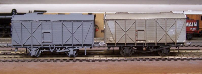

I've also been working on grain hoppers through the week; here one has had primer, one is ready for it.

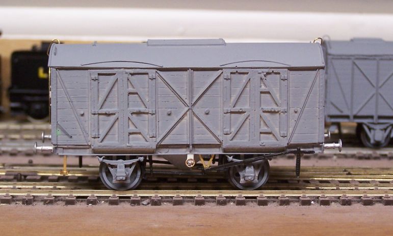

The resin one has taken most of the available time. I found some spare brake gear in the parts bin which saved some effort and the rest was really just a case of looking at Tatlow. I hadn't noticed, or had forgotten, that there's only one set of end steps on the master. Easy enough to make up. The steps are very vulnerable, it'll remain to be seen how they last. I've set them behind the solebar to try to get a better key and also make them less liable to catch anything. Only the very visible door locking mechanism to add now.

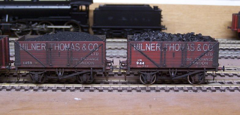

I'd seen pictures of the Oxford rail tank wagons and been impressed as well as hearing good reports from people who's opinion I'd take seriously. I have to say these are very good. I've done very little to these except complete the lettering over the strapping and fit Smiths couplings before weathering. They come with 3 link coupling loops but these are firmly closed so you can't use them with the Smiths hooks except by cutting them. I gather the Oxford hooks are functional, but I prefer the larger Smiths version.
Oxford's 7 plank minerals have been criticised in these pages but they do make adequate layout vehicles and credit to them for producing liveries which no-one else seems to have done. I'd not seen this particular one before, but a set of 4 came my way. The incorrect capping strip clips have been removed, LMS buffers, Smiths couplings and renumbering.
More Oxford, the Coventry Climax trailer pumps were also a nice little item which I'd seen used elsewhere. Matted down and with a dark wash they look very good. The crate by King's of Grimsby and the Colwick open which was looking for a load has been seen on these pages before. The LSWR open was in a job lot of wagons and had been scratchbuilt, probably in the 1970s if the date on another in the same lot is to be believed. The body shape was good but the brass strapping was awful - about 1.5mm wide, creased, with attempts at rivets randomly spaced and no attempt to chamfer or shape corners or joins. I did wonder about just binning it, but that goes very much against the grain so instead I repaired and reworked the bottom half and then applied a sheet as you see. It'll pass muster and can carry on running for another 40 years or however long the plastic lasts.
