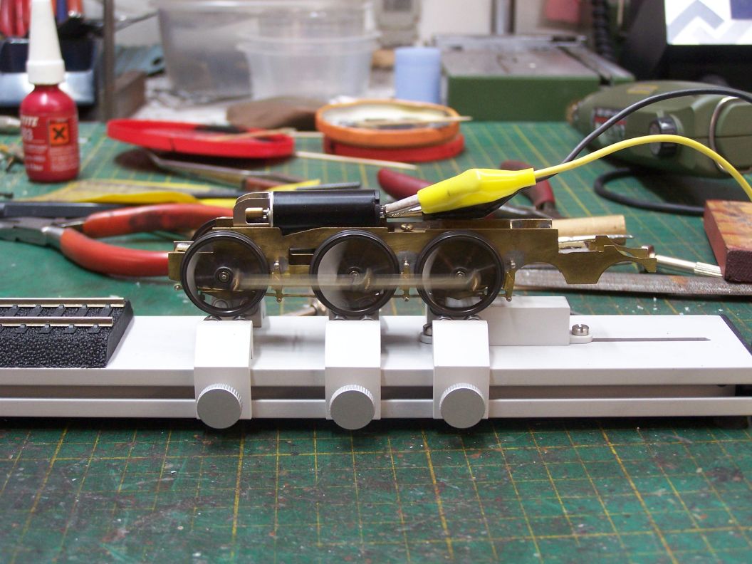

Bit of a hiccup with the B1 build; made up the gearbox, fitted the motor, applied flyleads and absolutely nothing happened. The (brand new) motor was completely dead.
As you'd expect, no dramas at all from High Level and a replacement arrived today. I've fitted that, fettled the coupling rods a little and it has had about half an hour on the rolling road this evening.

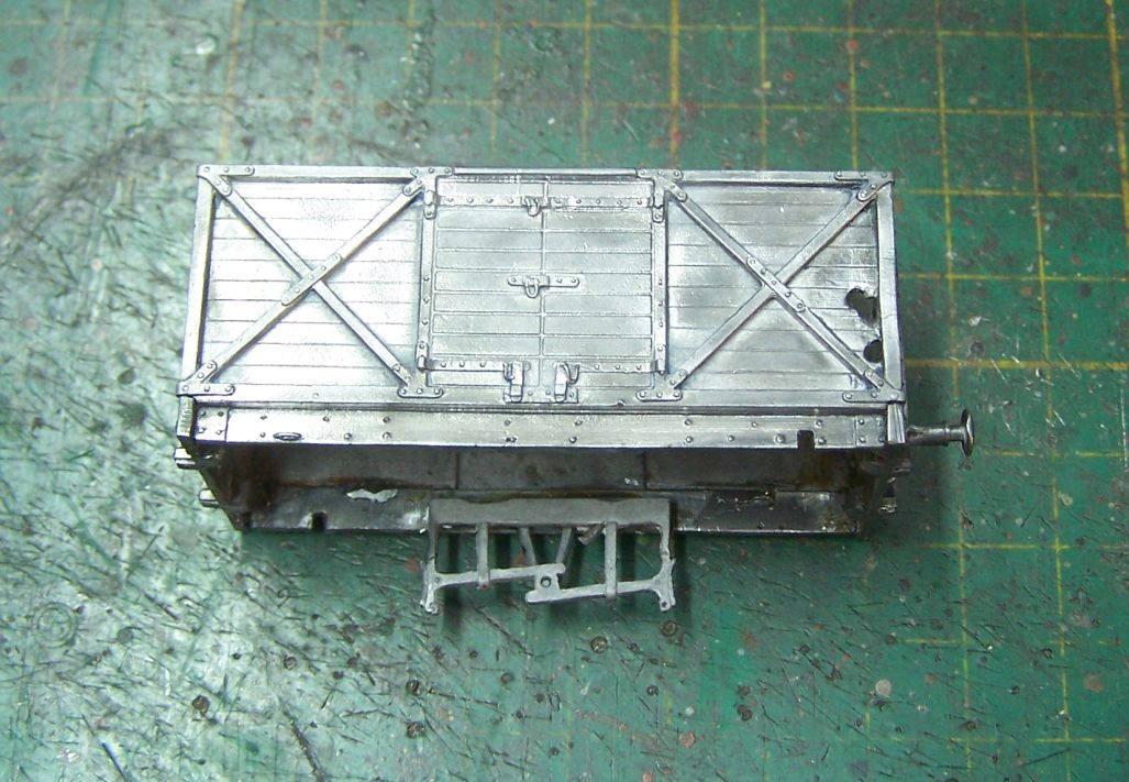

I've filled the gap with a few more wagons. I picked up three NER G1s on Ebay for less than a tenner each; incomplete but I had most of the missing bits in stock. When they turned up, it was apparent that whoever made them had done so partly with glue and partly with normal solder and a hot iron. He hadn't always got away with it either:

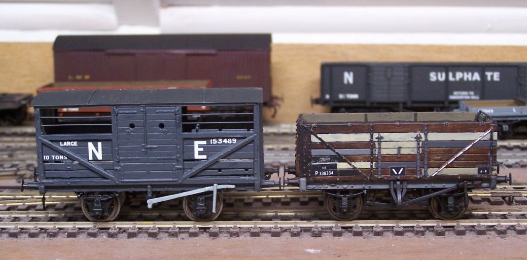

Cattle wagon lettered and the missing brake lever replaced (how many times did I pick it up before I noticed?). The mineral is Slaters.

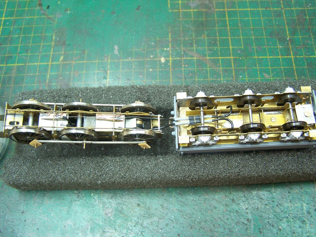

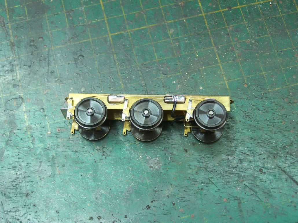

I don't think I'd build a tender loco without tender pickups now and the Comet tender underframe allows room to put them on top of the wheels, nicely out of the way.
The whole thing connected by my usual Peter's Spares plug arrangement which regular readers will be very familiar with. This bizarre looking ensemble ran up and down my layout two or three times this evening - enough of a test before it's dismantled for painting. I've added an unprototypical bar across the back of the brake rigging to hold the plug up clear of trackwork

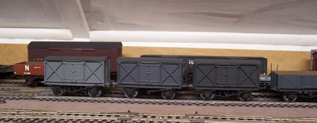

I haven't neglected the wagons: 3 G1s and a C10 now painted and ready for lettering.

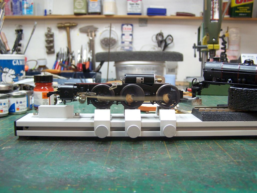

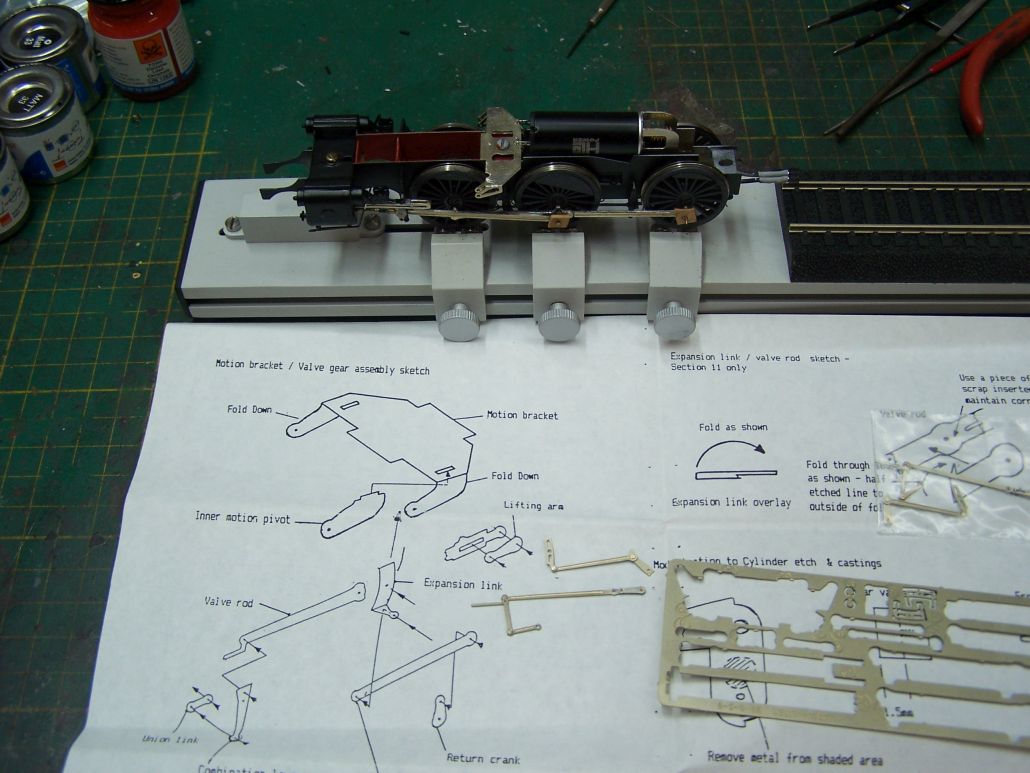

One step forward, one back.... first, the motion. The previous builder had made up subassemblies, so when I came to present it all to the loco I only had four bits to worry about.
Can't say it wasn't a fiddle - one side just fell together, I had to have three goes at the other - but in the end it's all on and runs freely on the rolling road. We'll get to test running in due course.

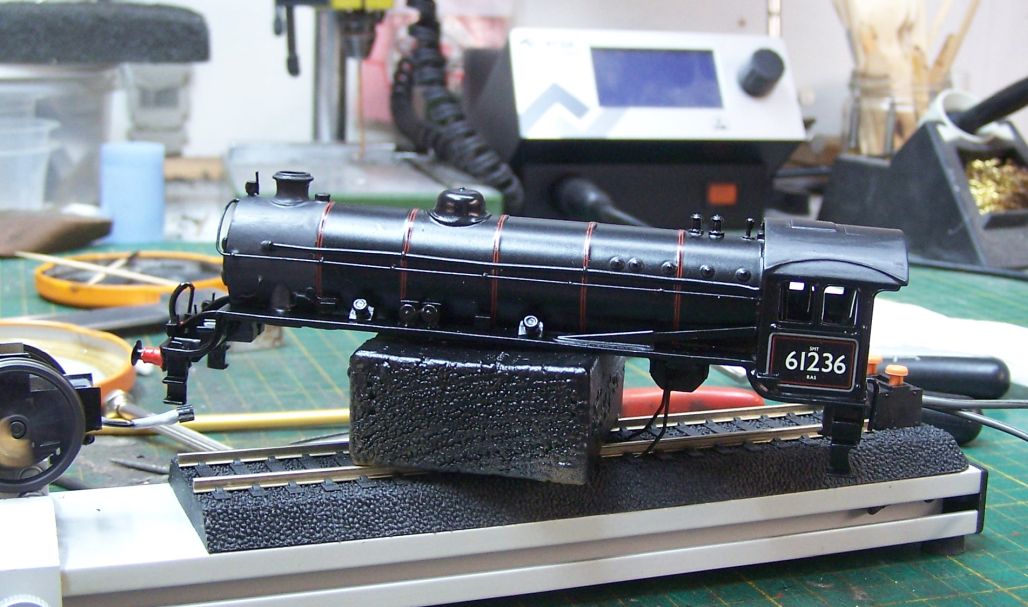

Now a step back... just a couple of minutes after taking that picture, I sprayed loco and tender bodies with Halfords lacquer - the same I use on everything - whereupon the cabside transfer wrinkled irretrievably all over the surface and the tender lining did the same. The boiler lining was unaffected, yet it all came off the same sheet. The air was blue.
I'll strip the tender but on the loco I've just scraped the cabside clean and smooth and I'll only repaint that. No need to redo all the boiler when it's absolutely fine.

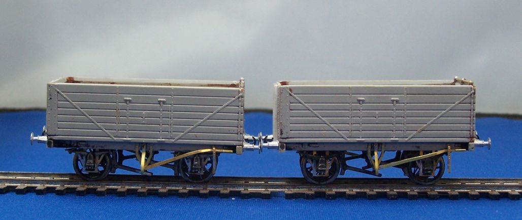

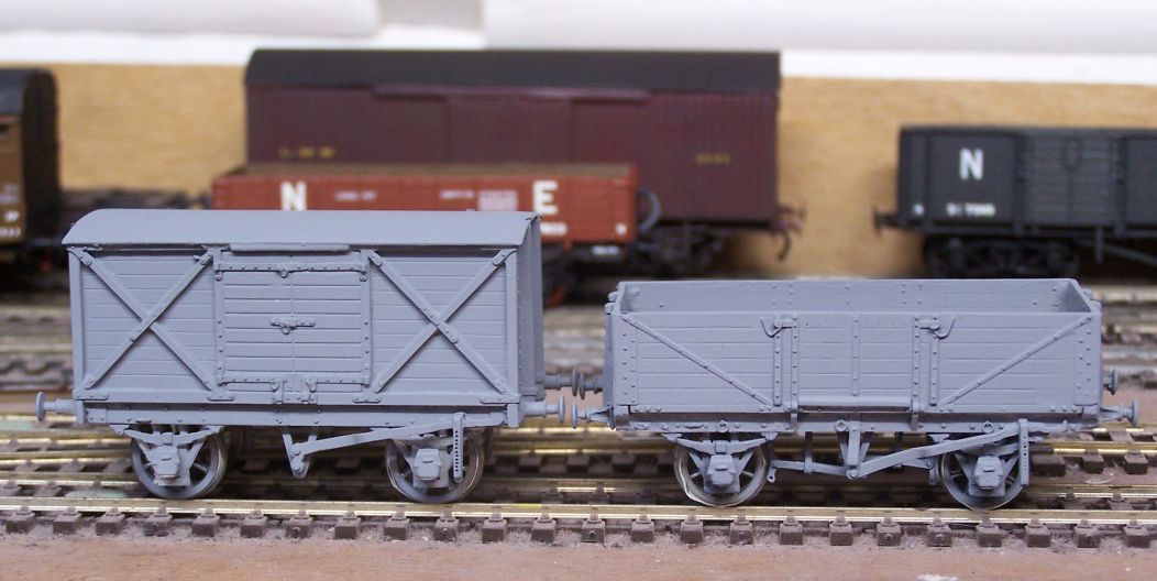

I've indulged in a bit of wagon therapy while stripping and respraying the B1. I fancied making some more minerals: the 1950s stock I have is a bit heavy on the steel wagons and the ratio should be roughly 75% timber to 25% steel for the early part of the 1950s.
First thing I happened on was a lot of 6 Ks 7 planks on Ebay which I scored for just over 3 quid each. I didn't recall that Ks had ever done a 7 plank mineral, but clearly they did. They're both plastic and basic, which was what i expected. They'd been built to EM gauge with what looked like decent wheelsets, so I decided to try to retain what I could.
You can see most of what i did here. The wheels are regauged but I tried the original W irons and bearings. The first one didn't roll very well so I replaced the bearings with some more modern Wizard Models ones and that ran a lot better. The originals have a very shallow hole for the pinpoint and seem to grip the axles slightly. Buffers from LMS, brake handles and external V hanger from Wizard, the rest made up from fret and wire.
The strapping is a bit insipid, but replacing all that would be a bit much. End stanchions are another matter and I've added my own. The ex-PO on the right has wooden ones, 60 x 40 Evergreen strip filed down at the top to represent the taper. The other one will be an ex-company example, so steel end stanchions from 20 x 10 and 30 x 10 Evergreen. You can also see where I've chamfered the tops of the sides and ends to reduce visibility of the overthick sides.
Having embarked on those, I then went to Redcar Show last Sunday afternoon and found that Dave Scott was selling some Bachmann examples which will need a lot less work. These were all factory weathered, but not unsalvageably so, so there's been a bit more distressing of planks and they'll now go to be weathered properly.
I called on Mr. Nicholas through the week as well and was lucky enough to be able to acquire a couple of wagons by Peter Lawson. These are both excellently built and painted and will drop straight into traffic, though I may weather the 6 plank a little more. That is whitemetal, I think from ABS and the mineral is Slaters.

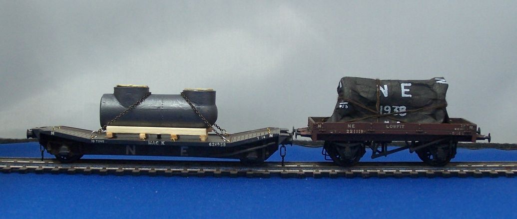

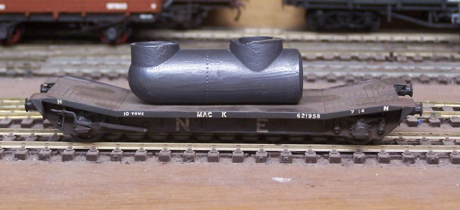

I wrangled a bit of chain this evening; the water valve is now firmly attached to its Lowmac. All this needs to be blackened, but again I've photographed it as is so those who take an interest can see how it's done. The Lowfit was gifted by Rob: I've done nothing to this except weather it. The load is bobbins - quite literally, it's a bobbin the Mrs. had finished with, filled with lead shot, screwed to the wagon, sheeted over and tied down. This will go into the Grantham Scotch Goods for the next show.
While I was in that sort of mood and had all the gear out, I did the Flatrol ELL as well. One of the drawings I have shows the chains laid out as here and I have a photograph where they're similarly deployed, so that'll do me. It's more interesting than a bare deck.

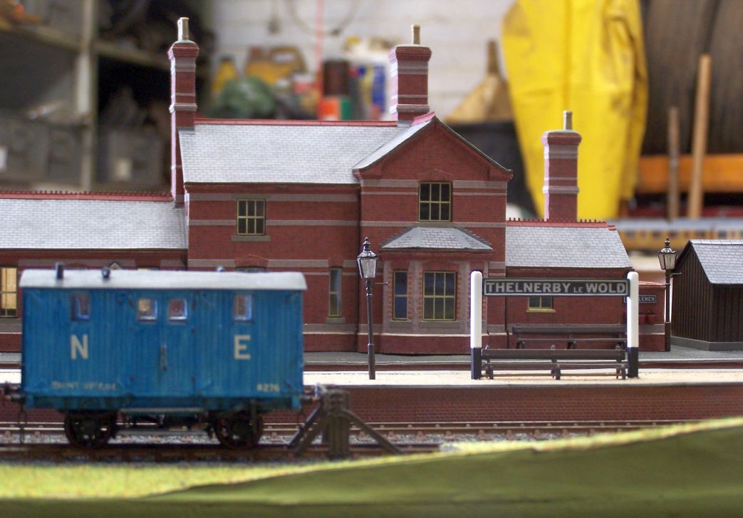

Well, we've had visitors for the Bank Holiday.
Bringing novelties with them:
This was a travelling test, to ensure everything needed to erect and operate the layout was included and no hurried late night trips to B & Q or Grimsburg would be needed to ensure completion. That test was passed with flying colours.
After that, it was a case of populating and operating it and working out fiddle yard dispositions, planned moves and the best way to run the thing in an authentic yet entertaining manner. As a bonus, or perhaps a quid pro quo, I got to exercise some recent wagon builds and some which had not yet been seen on a layout anywhere. To further enhance everyone's operating pleasure, Dave of this parish joined us on Saturday with some goodies of his own. So, in no particular order (because I already can't remember the order they were taken in), here are a few teasers for Immingham 2025:

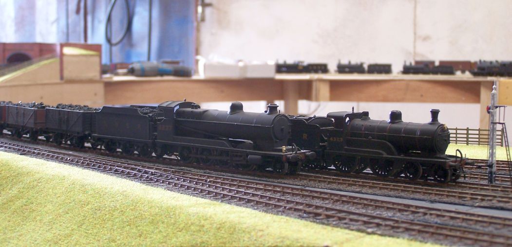

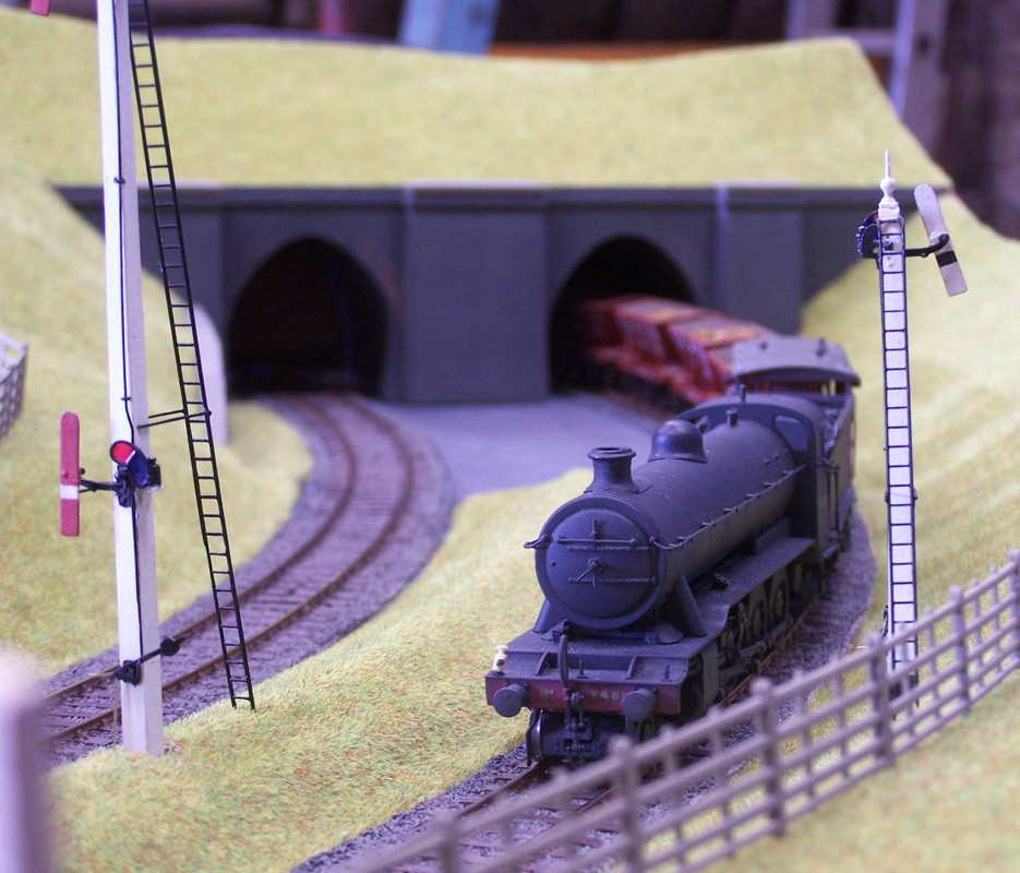

O2 with iron ore heading for Scunthorpe. This started as a through train, but we may have more ambitious plans for it.
O4 heading Down with the line limit of 21 loaded minerals.

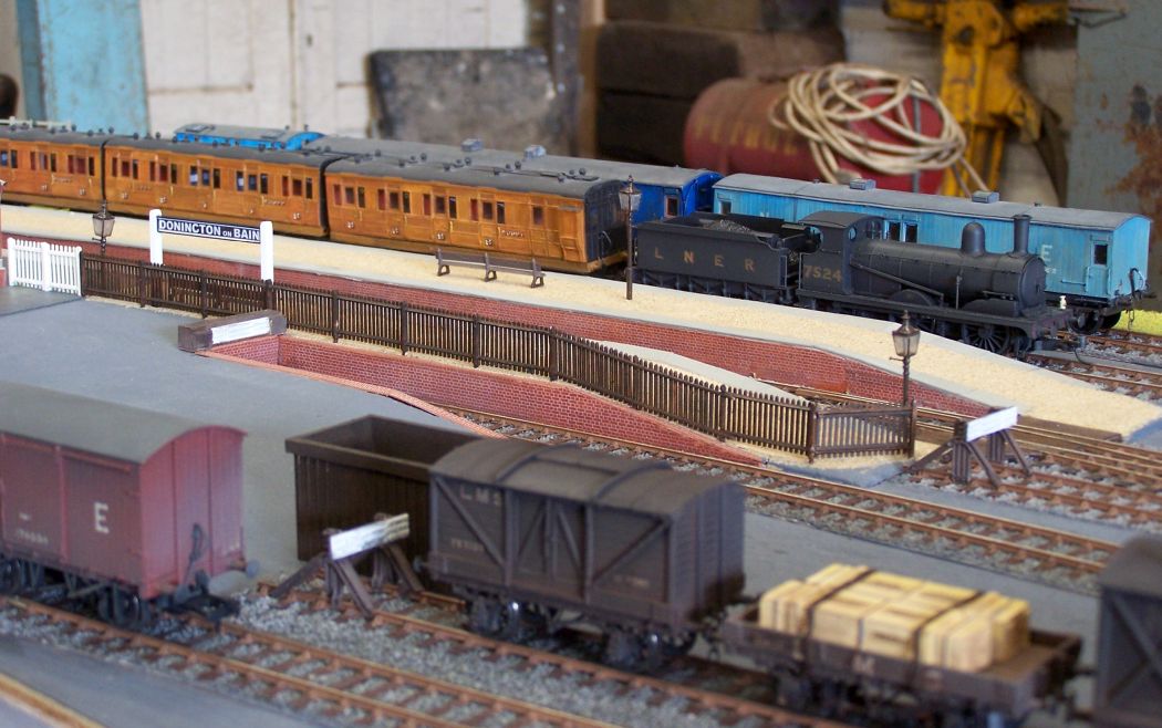

Station building and Mr. Job's Pooley van - just passing through, there's no weighbridge to calibrate as yet.
Hornby J15 on a D & S Quad set. After the lengthy saga of the J15's squeal, it didn't perform to par, barely managing this set. I fear a firm talking-to is in store when it returns home. Dave's scratchbuilt stores vans in the background.

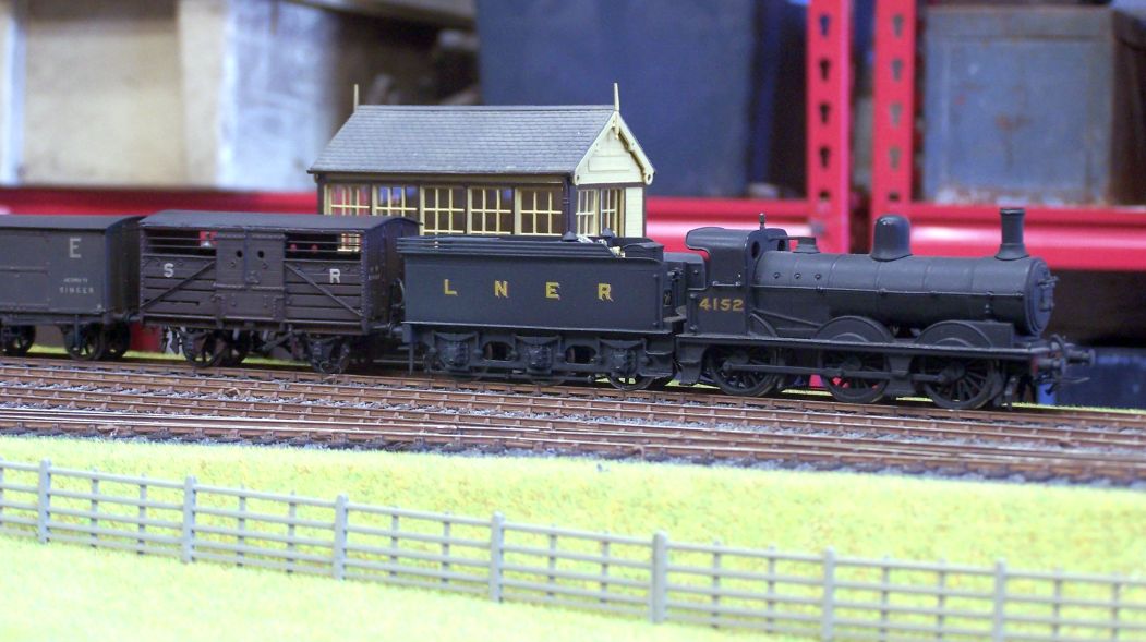

4152, a former Grantham regular by Ks, with a local goods service as we shunted the yards for the first time.

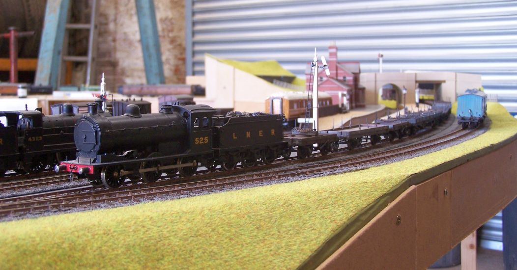

Dave's NuCast J26, 525, (Built by Dave Scott) with a train of empty bolster wagons also heading for Scunthorpe and the steelworks.

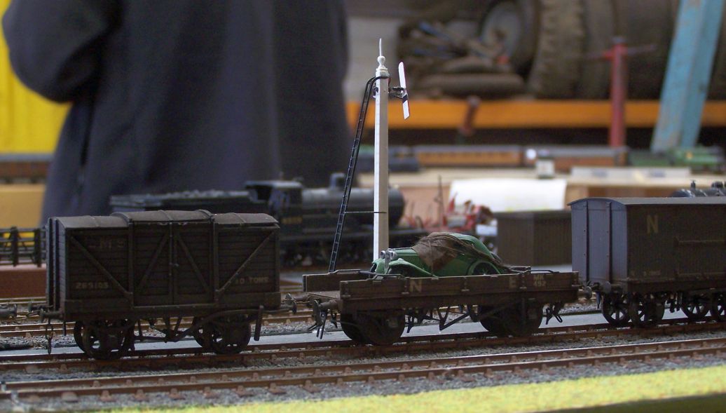

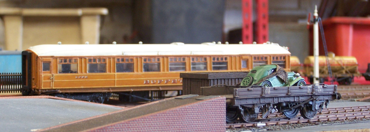

GN OCT at the loading ramp with a vehicle secured for transport. The buffet car behind (also by Dave) must have been knocked out for a hot box or run out of cucumber sandwiches, or something.

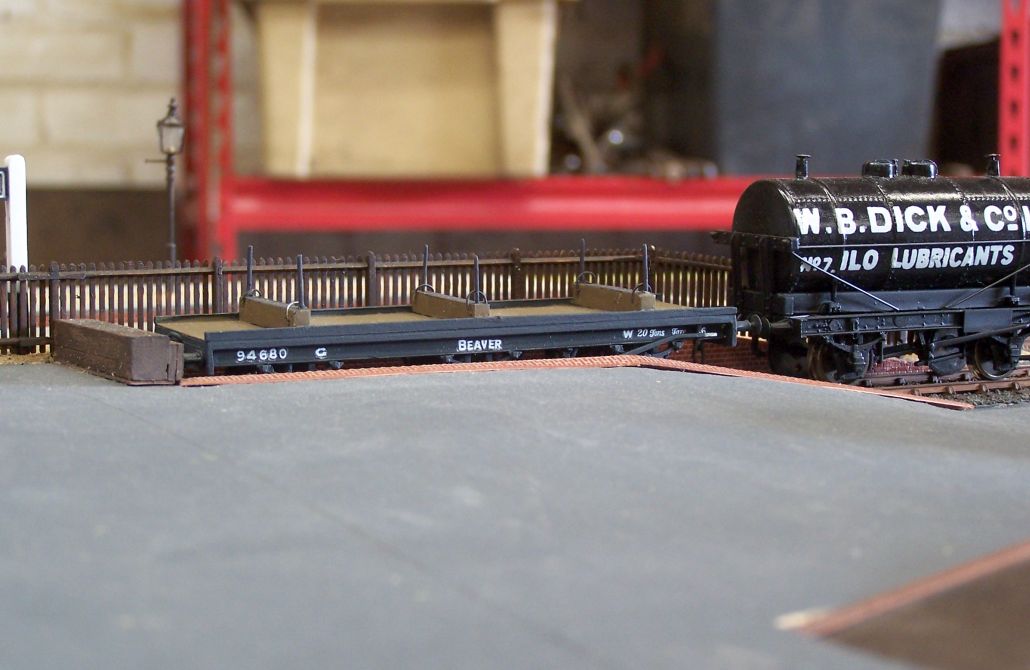

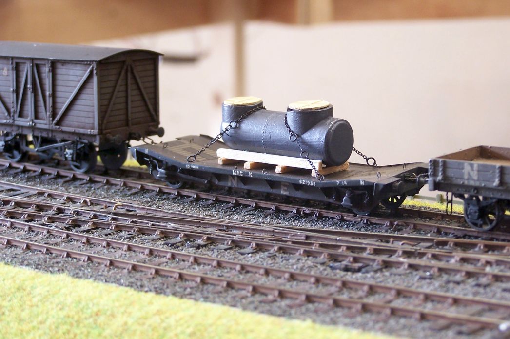

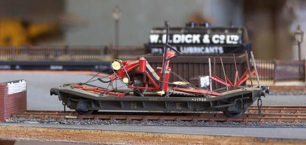

I took the opportunity to run the loaded Lowmac which I finished off very recently.
A delivery of timber with runner wagon at this end. Again, I did a set of these to amuse myself some time last year and this is the first time they've gone out to a layout.

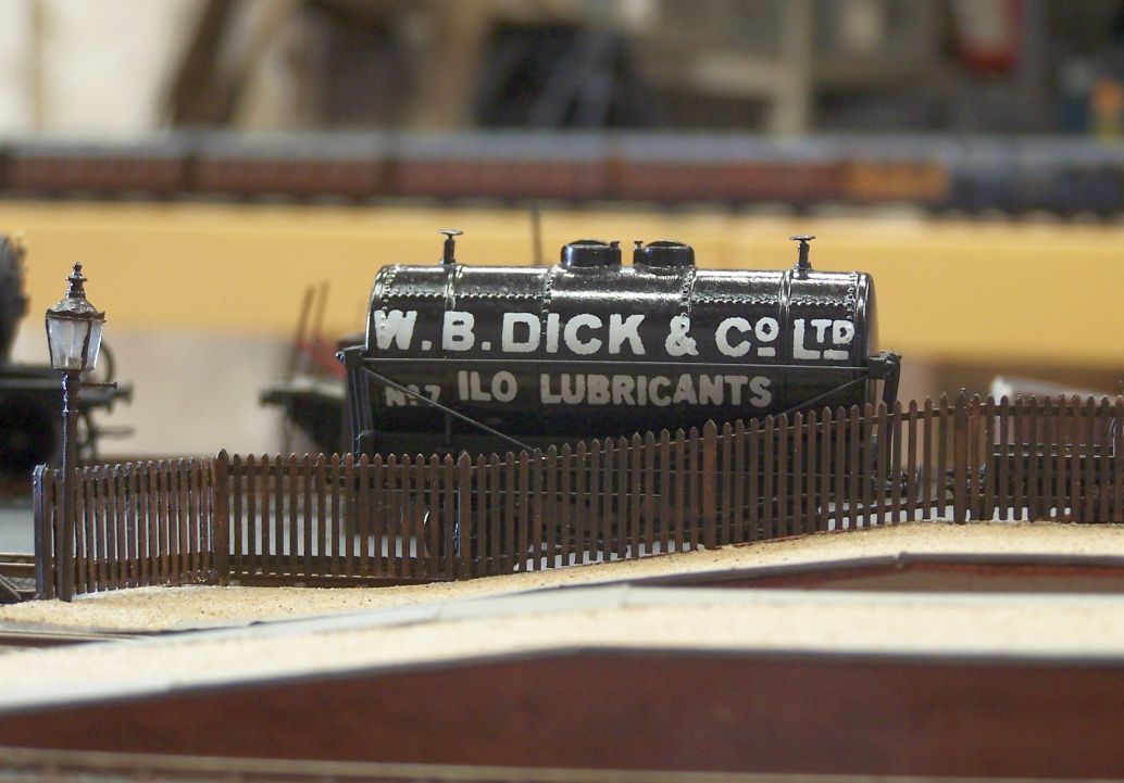

Inevitably, the tone had to be lowered.
Equally predictably, where there's a Dick....

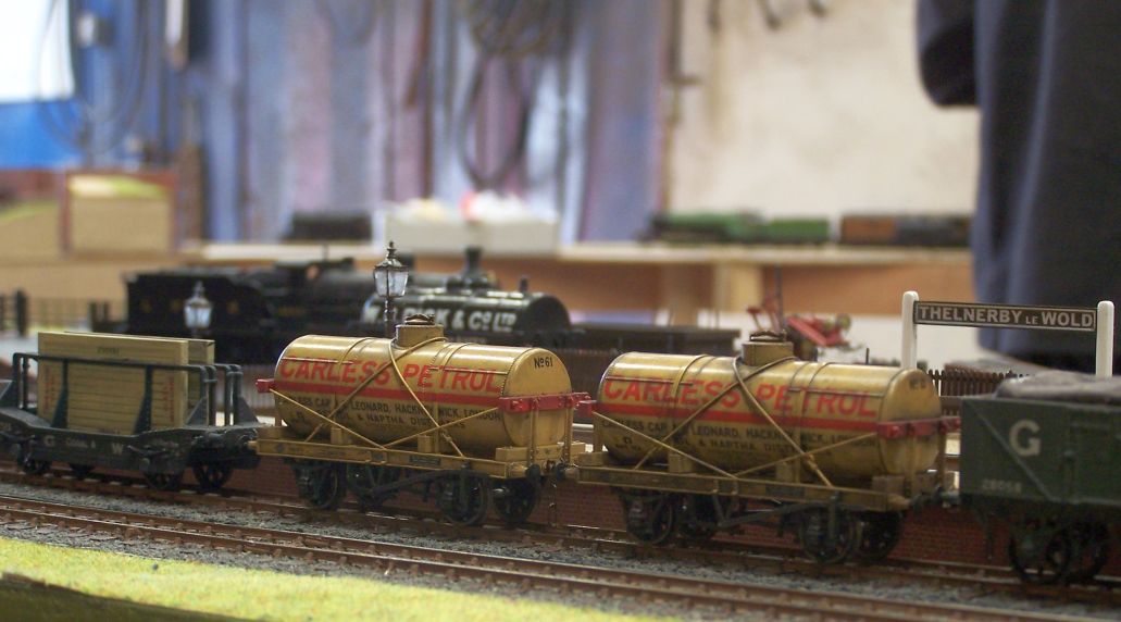

I think the local WI may have bitten off more than they can chew with this knitting machine they've ordered.....
A pair of Oxford Rail tankers. I quite like these, I have to say.
247 Developments Coral glass wagon. I think this was the first chance I've had to run this away from home.
OCT collected and on its way to who knows where.
All things being equal you can see Thelnerby in the flesh, so to speak, at Immingham Model Railway show next May.
